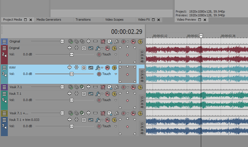

I'm having the same issue with connectors 0.7.0, 0.7.1.
In my view the audio rendered in voukoder is 1 frame AFTER the original audio, just see that the peak of the audio signal is on the right, when compared to the original audio. This happens in mine and in your screenshot.
Sure. But previously you said 'ahead', not 'after'. I said 'behind' == 'after'.
Yes, I also have the new so4 decoder disabled in internal preferences as it does not work correctly with my AC3 5.1 audio streams.
I'm confirming that when the so4 option is in default value (TRUE), the audio in mp4 file rendered with voukoder connector 0.7.1 is in sync with original audio.
When the option is in non-default value (FALSE), the audio in rendered mp4 file is 1 frame behind.
You do not need to re-render, just change the option, restart VP, put original an rendered on timeline & compare.
I've found my footage with Stereo (1080-59.940p, AC3 Stereo) and only see 1 frame offset after rendering (audio 1 frame behind original audio. I do not know why other member says it is ahead, based on his screen shot I'd say it is 1 frame behind).
Then I was able to correct it further using atrim filter (Start = 0.033, start in frames did nothing):
