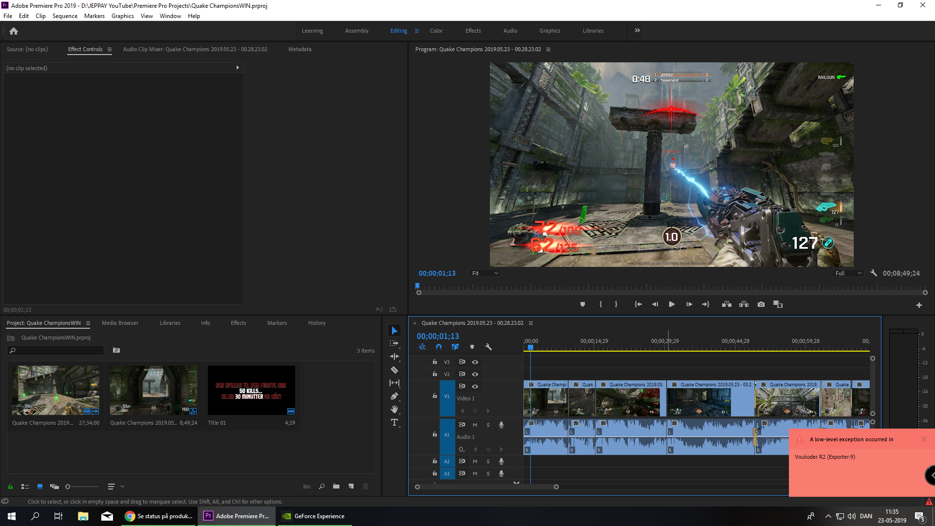

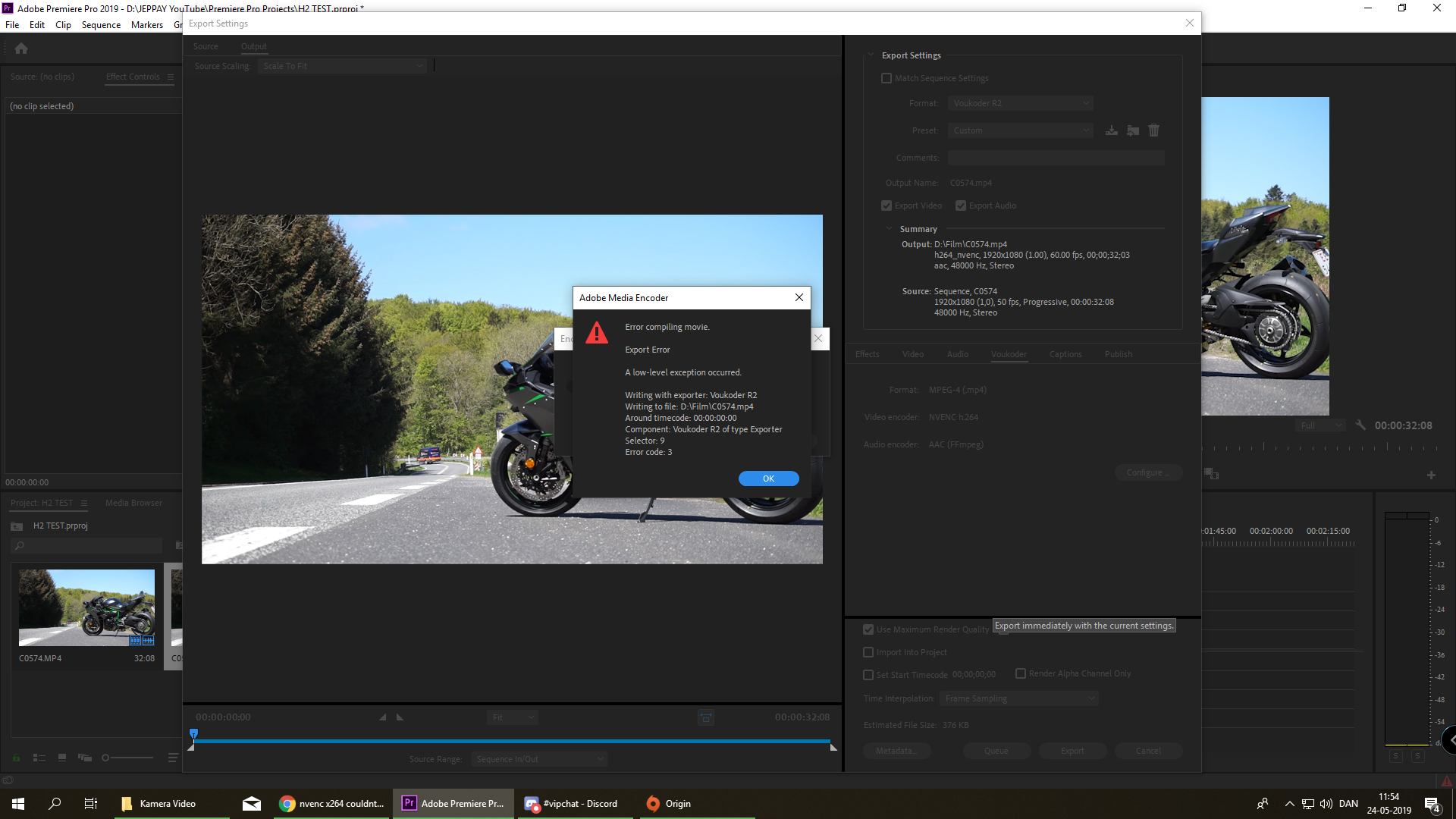

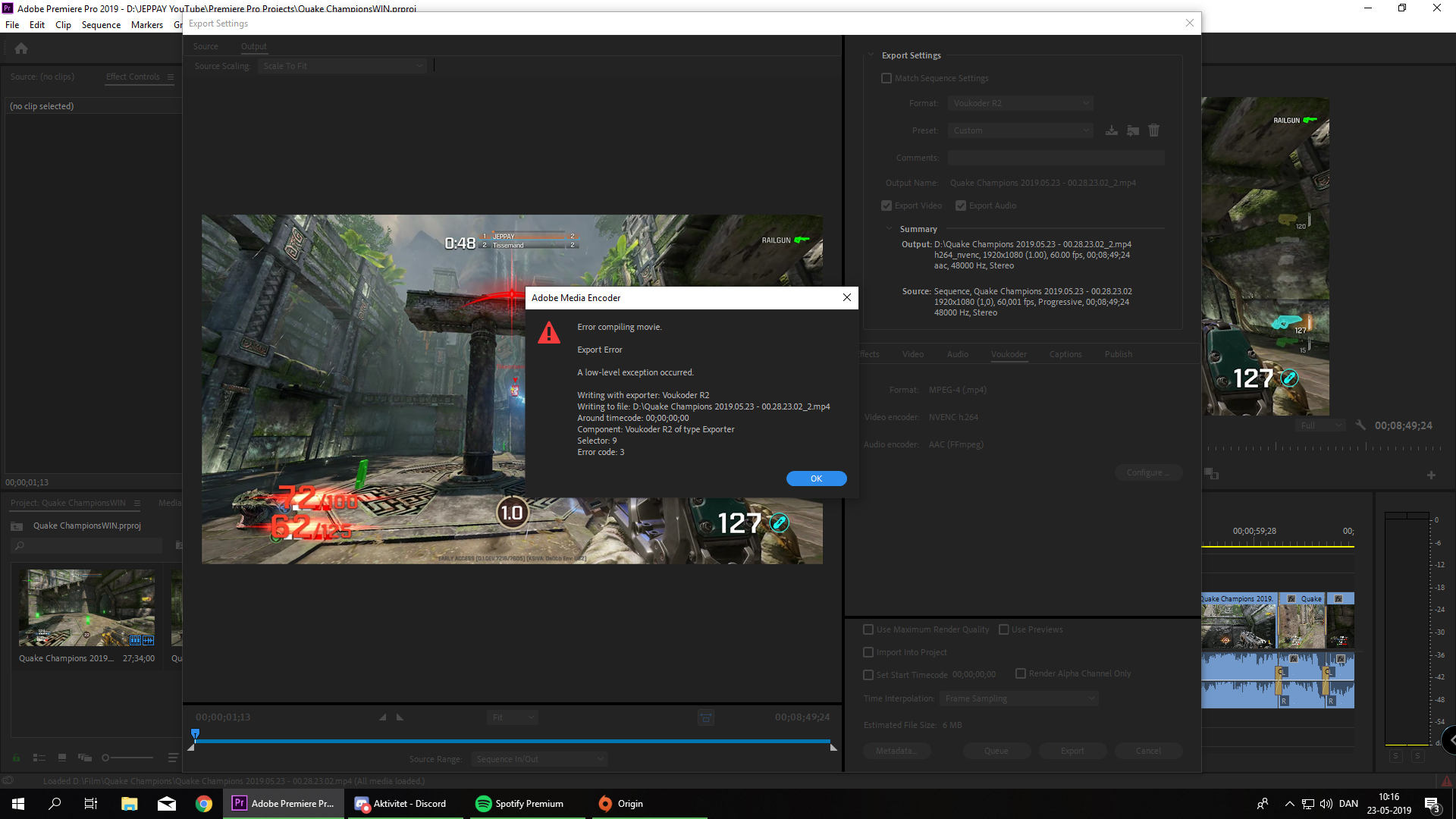

- Encoding Time: 00:01:27
06/23/2019 08:28:21 PM : Encoding Failed
Export Error
Error compiling movie.
Export Error
Exporter returned bad result.
Writing with exporter: Voukoder R2
Writing to file: D:\PSSD\VIDEOS\TAIPEI2018\Header\PAPA.mp4
Around timecode: 00;00;01;03
Component: Voukoder R2 of type Exporter
Selector: 9
