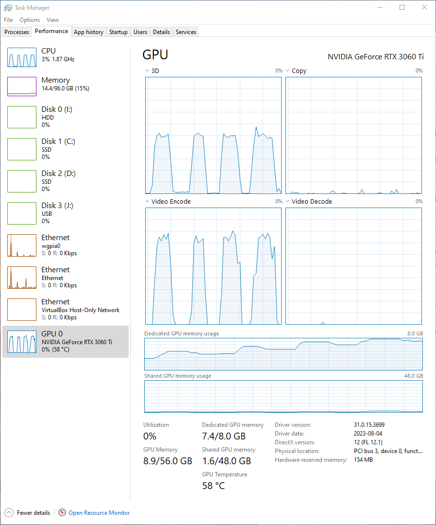

Sequence of actions starting and stopping the same render job, with VRAM usage (8 GB card):
- Windows idle: 0.4 GB
- Loaded 2 instances of Vegas 20: 1.8 GB
- During 1st render: 3.6 GB
- After 1st render: 3.0 GB
- During 2nd render: 4.8 GB
- After 2nd render: 4.1 GB
- During 3rd render: 5.9 GB
- After 3rd render: 5.3 GB
- During 4th render: 7.1 GB
- After 4th render: 6.4 GB
- During 5th render: 7.8 GB (paging)
- After 5th render: 7.2 GB (possibly paging)
- During 6th render: 7.8 GB (page 10 GB)
- After 6th render: 7.2 GB (paging)
- During 7th render: 7.7 GB (page 12.x GB)
- After 7th render: 7.3 GB (page 11.3 GB)
Screenshot taken partway through the test run:

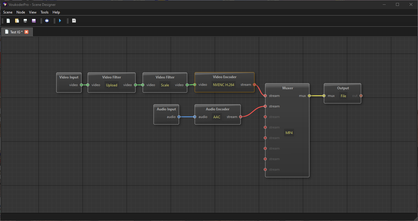

If i try that my I have the ffmpeg error again
(Video Input) -> (Video Filter: CUDA Upload) -> (Video Filter: CUDA Scale) -> (Video Encoder: NVENC H.264 with input data type set to "CUDA") -> (Muxer) -> (Output)
Or if you want to use your graphics card hardware to do the scaling:
You can unzip and import this file into Scene Designer: scene2.zip

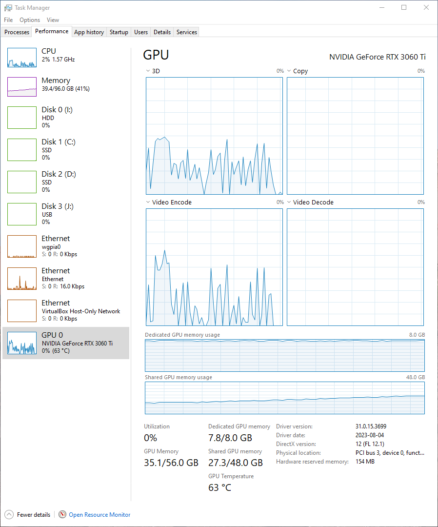

Graphics card memory doesn't seem to be released after encoding with VoukoderPro. Up to and including v0.7.2.6.
I have GPU globally disabled in Vegas 20 (because it slows rendering down - it's a Vegas thing!).
Typically I'm running 2 instances of Vegas in parallel, and rendering in both simultaneously using NVENC through VoukoderPro. My first pair of VoPro renders usually use about 3 GB of VRAM. When the renders end, the memory is not released. If I run a second set of renders, now usage is up to 6 GB. If I run a third set of renders, now usage is 9 GB (paged, my current card is 8 GB). And so on.
This behavior has not been observed with other render methods, including Voukoder 13.0.2. These other methods release the video memory as soon as the render is stopped/finished.
The memory is released if I restart Vegas.
Ah cool, tnx for that example, should have realized that the muxer needs to be in between every encoder and file
Edit*
how do you get the muxer to switch to wav or mp3? mine still remains at the choice of the 4 video formats only
Uninstall your VoukoderPro version, and install the latest beta. The version you were using doesn't have WAV/MP3 capability. The new versions do.
