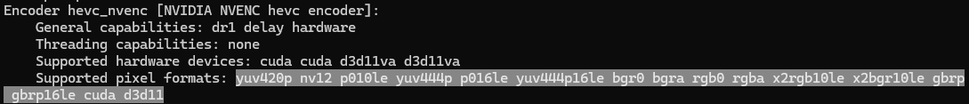

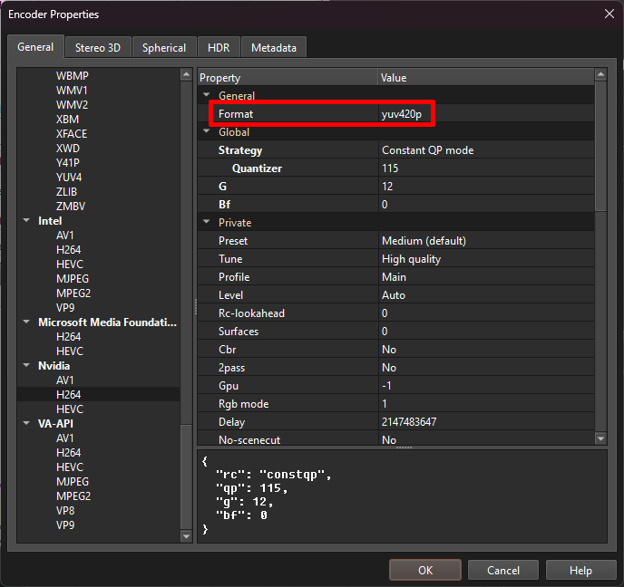

Looks like you're trying to export with the format cuda. This is not necessary if you just want to encode with the GPU. Just select i.e. yuv420p as format.
If you want to intentionally use cuda it'd requires you to upload frames from the PC memory to the GPU device first (using the upload filter), then apply a chain of NVIDIA filters, and then process it with the encoder (This still has to be documented).

Looks like they have renamed one setting but they are supporting the old and the new variant. Seems like I have to hide the old one.
You can use both, old or new one. What counts is shown in the options preview box below.
