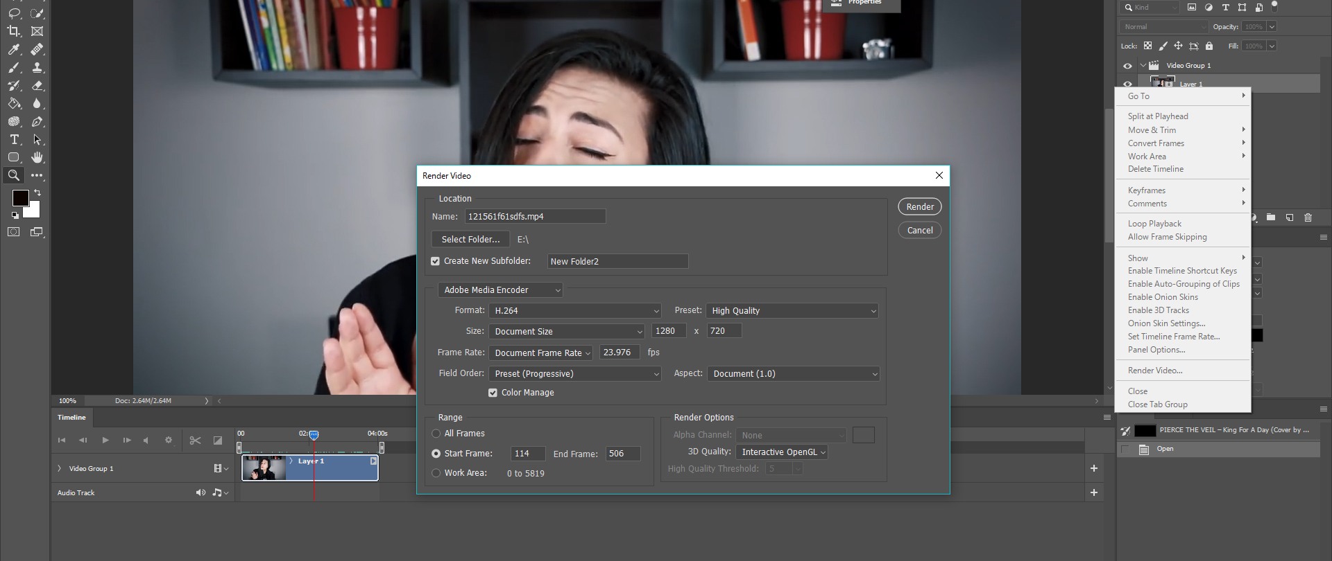

    A video exporter for PhotoShop? I didn't know you can export videos with PS.
    yes you can! and very long time..maybe from 2015 year?..
    and you can use all of it power// ACR, smart sharpness, lens destortion, layers..
    it very great, but... stock exporter is shit...if you can add your plugin working atleast with prores, it will be new step and many great people for this.

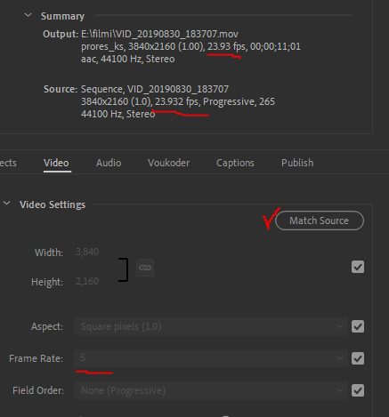

    Hi, sometimes it conflict with NeatVideo. i think it is some memory conflicts
    i have 2 same projects with same scene but different videos, and only neat video plugin inside. i try to export it in prores4444.
    so one is exporting withot problems, but long one everytime error, on 1sec or 3sec..
    i try 1ver of voucoder, and last, same problem.. i try to reset PC and etc..try to render 5-6 times...so it cant.
    but when i start use default quicktime codec in AME, not NVENC, i export same Prores4444 and it exported just fine///
    here is a log.
    Exporter returned bad result.
    Writing with exporter: Voukoder R2
    Writing to file: E:\filmic\VID_20190830_183707_1.mov
    Around timecode: 00:00:02:15 - 00:00:02:16
    Component: Voukoder R2 of type Exporter
    Selector: 9
    Error code: 20
    - Encoding Time: 00:01:09
    09/10/2019 01:37:33 PM : Encoding Failed
    Voukoder R2
    Failed writing video frame #61. (Error code: -22)

    hi, can you do pluguin for export atleast one ProRes in photoshop? we all want use ACR power in our videos but default video muxer in PS dont use GPU, and can render with effects only on jpg (in adecuate size) but even this works very bad and soo slow...also RAM issues here.. im with 16GB and can export only 114frames in 4k JPG with ACR NR only and smart sharpnes..only 2 plugs.. im so sad with this now.. we will be very happy if you can do atleast small of features, as ProRes only. best regards
