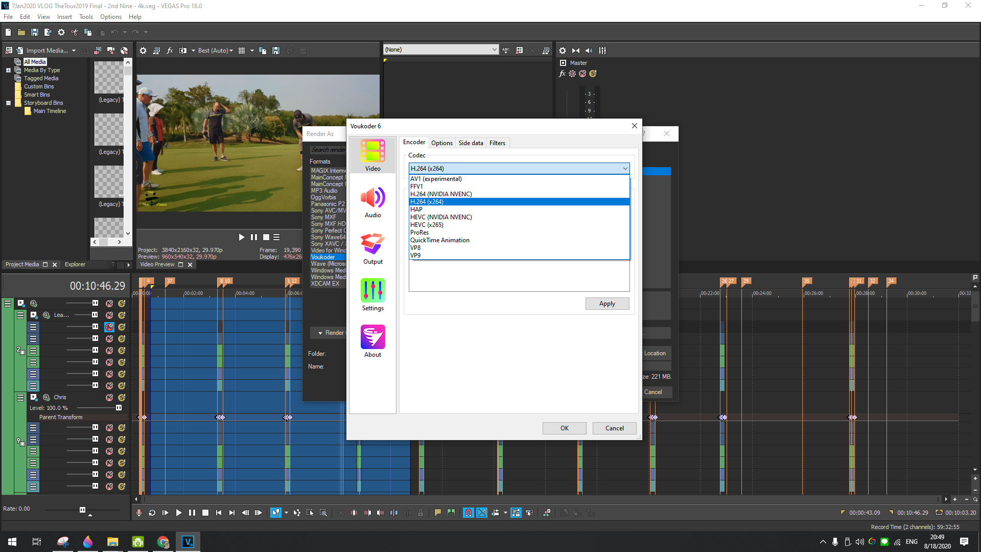

    HVEC (H265 using GTX 1070 Ti Driver Studio 451.77) is the fastest encoder for me.
    I've tried several standard options on the same clip:
    Fast Main Main QP13 = 1077 sec & 970 MB
    HQ Main Main QP13 = 1076 sec & 964 MB
    HQ Main Main QP15 = 1073 sec & 763 MB
    Slow Main Main QP15 = 1072 sec & 763 MB
    Slow Main High QP15 = 1061 sec & 763 MB
    Slow Rext High QP15 = 1078 sec & 763 MB
    => The overall time is the same, using Fast/Slow/High Quality, Main/REXT Profile or Main/High Tier (that's strange to me)
    I suppose that Vegas Rendering is actually holding back the encoding.
    So, for my next benchmark, I'd like to force higher compression (lower file size without reducing quality).
    I suppose I need to dig into the Advance Option?
    What would be the suggestion to increase compression on a 4k 30 FPS clip?
