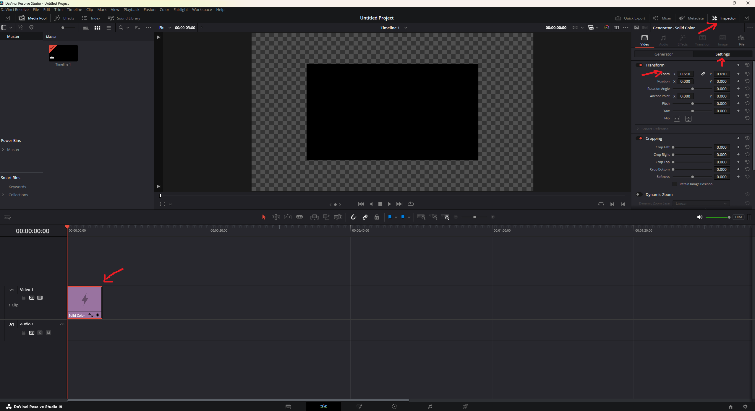

    It's actually pretty simple in steps
    Create a new timeline and optimally set the Viewer Background to Checkerboard (so you know when it actually has transparency)
    After that, go to Effects -> Toolbox on the left -> Generators -> Solid Color and drag it onto the timeline
    Then click on the Solid Color effect in the timeline, make sure Inspector is enabled in the top right, then click on the Settings tab and then change the Zoom to be smaller (so it shows transparency in the background)
    After that, head to the Deliver tab and select a format and codec that support Alpha (one example would be QuickTime with GoPro CineForm and RGB 16-bit)
    It will show the Export Alpha checkbox like so
