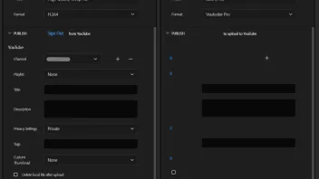

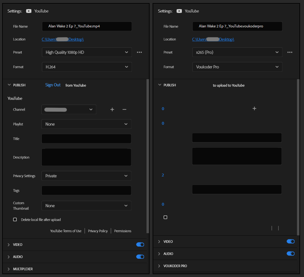

Well, here's another fun one. When the "YouTube" destination of the Export tab is set to use a Voukoder Pro preset, the UI in the Export panel gets all screwy, as seen in the attachment. I just toggled between two presets, and you can see what happens. Very odd. Trying to use the "Send to Media Encoder" or "Export" buttons doesn't do anything. Everything renders out perfectly fine in the "Media File" destination, but one of the reasons I pay for Premiere is for huge Media Encoder queues.

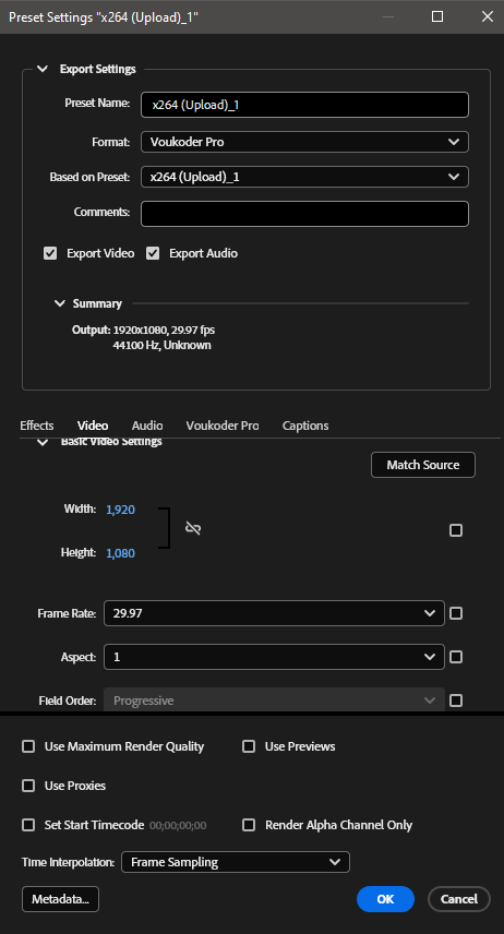

Aha! It lives! Whatever you changed made it suddenly produce correct files! I did note that Premiere was previously adamant that my input FPS was 29.97 (instead of 60); once I'd finished screwing around, it identifies the actual timecode! (easiest to see in the preset settings, in the "Summary" window.) Thanks again for your help and work!

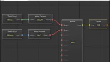

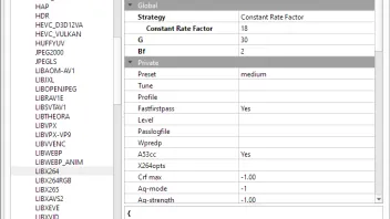

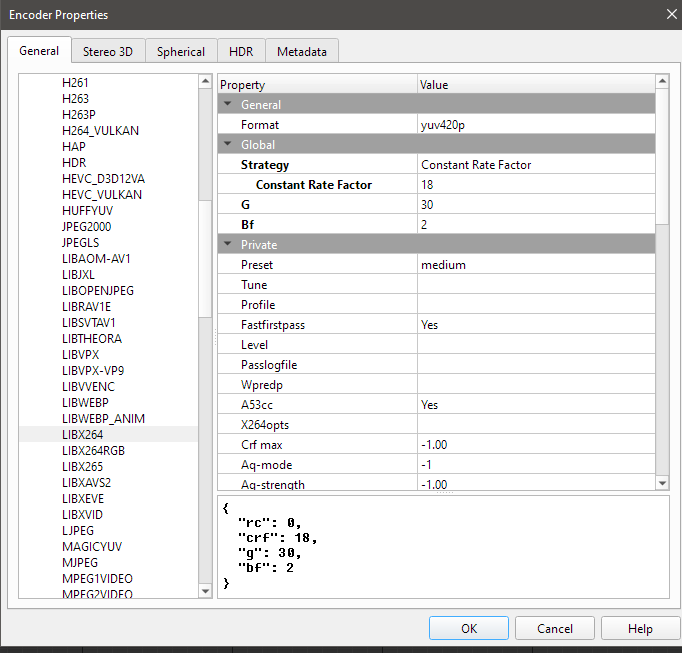

[For future web searches] If anyone's curious, these are the settings I use. Bear in mind, this is for recorded gameplay -> YouTube. For the items in the Designer, the text in curly braces {} is what you should see in the bottom window:

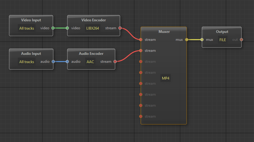

Designer
Video Input: All tracks
Video Encoder: LIBX264, CRF 18, G 30, Bf 2
"rc": 0,
"crf": 18,
"g": 30,
"bf": 2

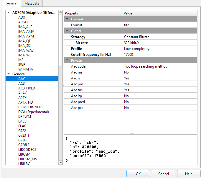

Audio Input: All tracks
Audio Encoder: AAC (General), CBR 320 kbps/s, Low-complexity, Cutoff 17000 Hz
"rc": "cbr",
"b": 320000,
"profile": "aac_low",
"cutoff": 17000
Muxer: MP4
Movflags: Faststart: True [often called 'moov']
"movflags": 64
Output: File

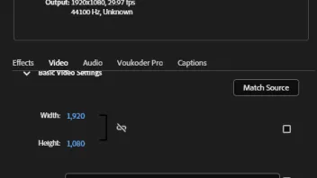

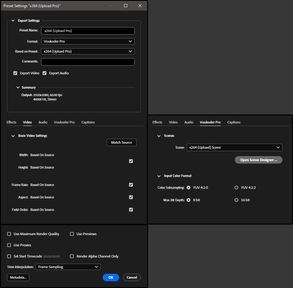

So. Here's my pain. This is Adobe Premiere/Media Encoder v25.1 (the most recent as of this post), computer is Windows 10 and gets along with Adobe suspiciously well.

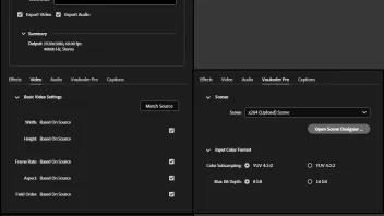

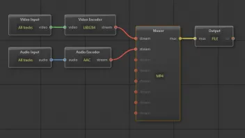

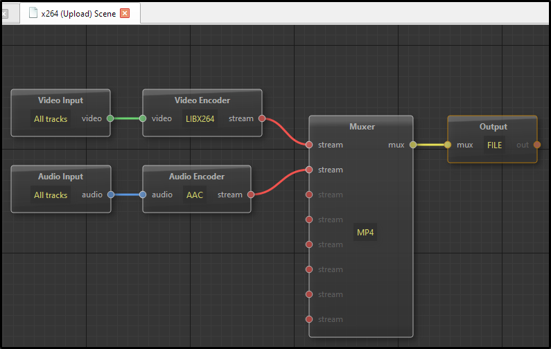

Virtually everything I do is YouTube uploads, hence some of the options (or I was too tired to click my mouse again). As you can see in the "Designer" file, I'm running video through libx264, audio through AAC, muxing them to MP4, then tossing it in the output folder.
You can see the options listed in the "Video" file, encoding via LIBX264, basically stock. Generally I'd mess with it more, but I wanted to just do the bare minimum of changes. "Audio" is just straight-up AAC, CBR 320, low complexity. The MP4 output has the faststart flag set.

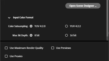

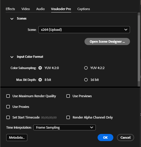

And now the horror that is Adobe presets. I tried to capture most of it in the "Fill size preset" image (Premiere is being a bitch and adding "_1" to the end of all my presets). This is just showing that I'm not doing anything weird except that I forgot to set the framerate to 60 for the screenshot. The "Smaller preset" image is the Voukoder Pro tab, I just left the color options alone.
