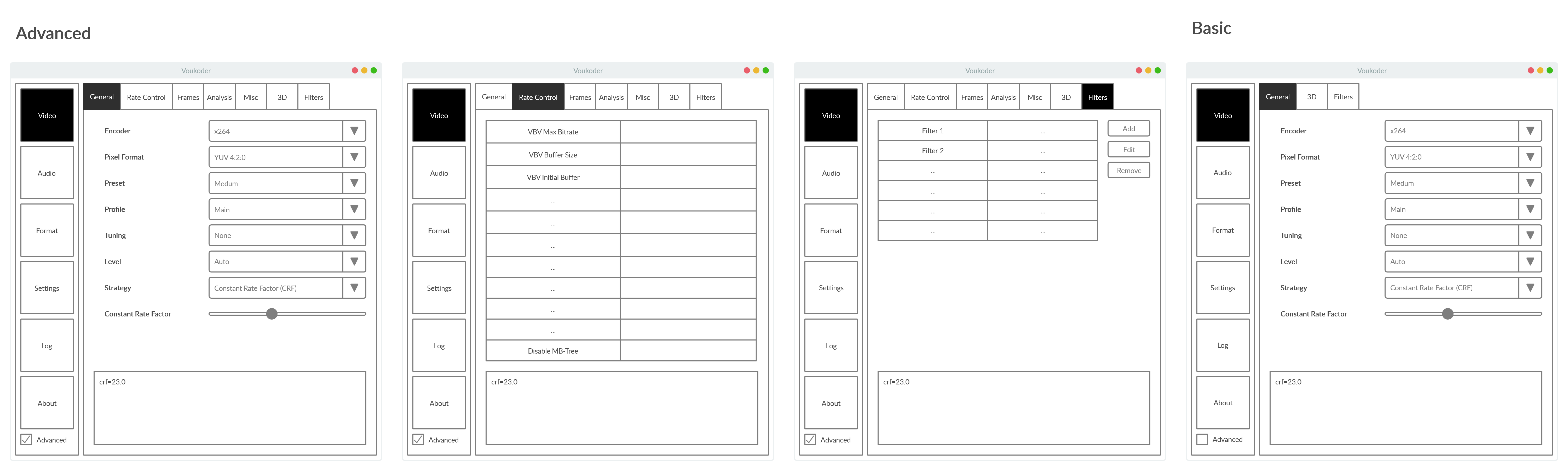

    If you want, you can separate it visually: by tabs colors or alignment (encoder on the left, others on the right with the gap in the middle) for example. Maybe somehow another way. However, I do not think that it must be. It may, but not must/have to. Also it can increase complexity of UI, depends on implementation. For me as a user do not matter if some options are encoder dependent or independent. For me is more important that all things on the right (logical) place and I can quick navigate to needed options/section or overview options without scroll. And I am not ffmpeg user. Maybe separating options is more important for ffmpeg users? Or you have some other reason? Could it be done by another way?
    Additionally, I just found out that most encoders have significantly less encoding options then x264/265. Show only 1-2 option(s) on a separate tab could be a little bit strange. it also should be sorted out somehow.

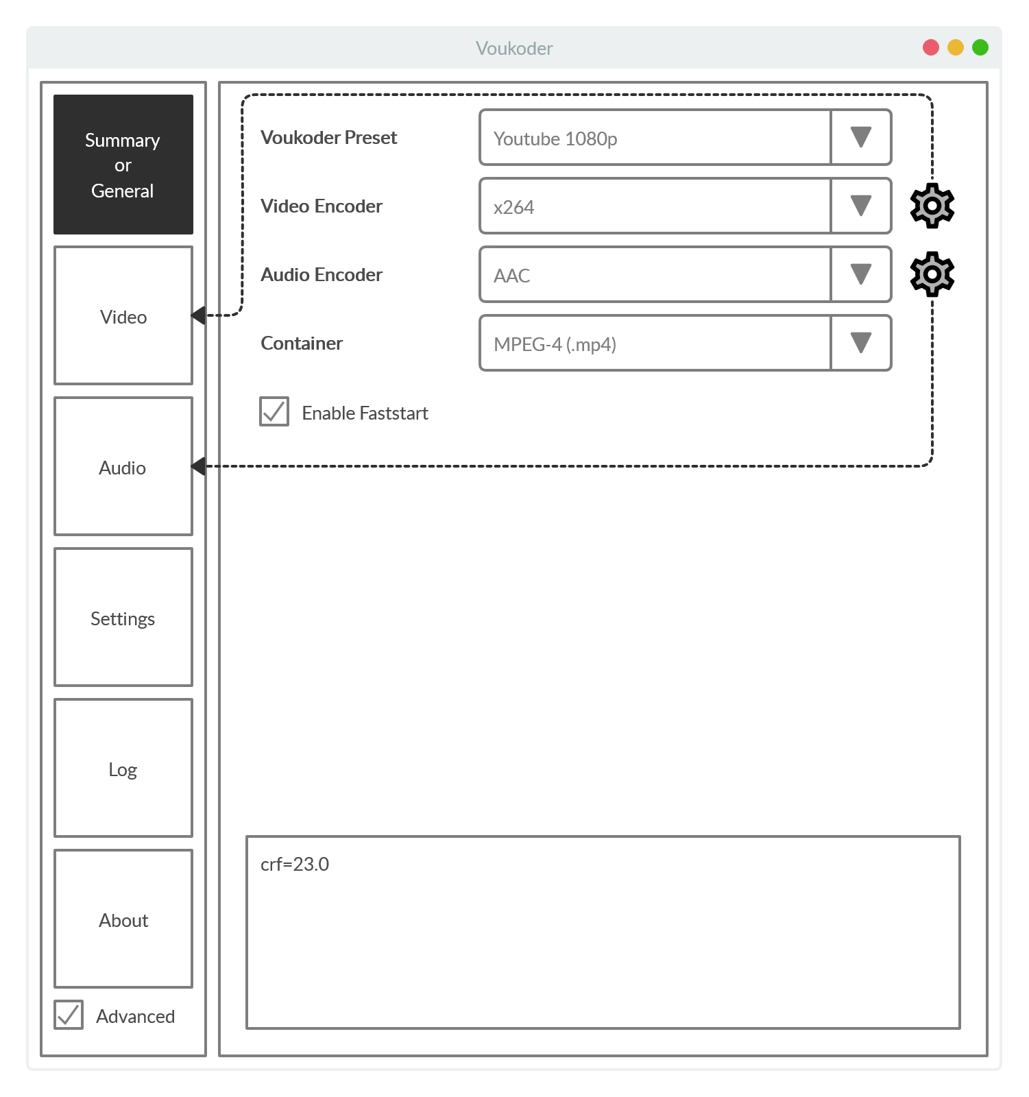

    1. The selection of the "Format" depends on the selection done in "Video" and "Audio". I am still trying to find out if there is a more clever way of displaying this workflow / dependency.
    Return to General icon :)
    4. 3D & Filters - It would be possible to put these tabs here. BUT - It could be confusing as these are not encoder options, plus they are encoder independend. They will not be affected when the encoder gets changed and they won't get cleared or resetted when the encoder options does.
    Both "3D/Spherical" and "Filters" will be not used by the majority of the users. So I still think it could be reasonable to add buttons that open a new dialog. Not sure about it though.
    Video icon on sidebar is not about encoder, it is about video stream in general. 3D/Spherical (3DS) can be encoder independent, but it refers to video stream. The same thing with filters. However you can place separate 3DS and Filters icons to sidebar. But video and audio filters should be separated, examples:
    - two tabs Video and Audio
    - two grids on same screen (maybe best variant)
    - one grid but with additional column type: audio/video
    Aditionally about window size. Seems you are designed it for compatibility with HD (720p) screens. I am not sure if somebody use Adobe products with such low screen resolution. Maybe it make sense to rise requirements higher up to FHD (1080p) screens and it will allow to increase default size of main window.

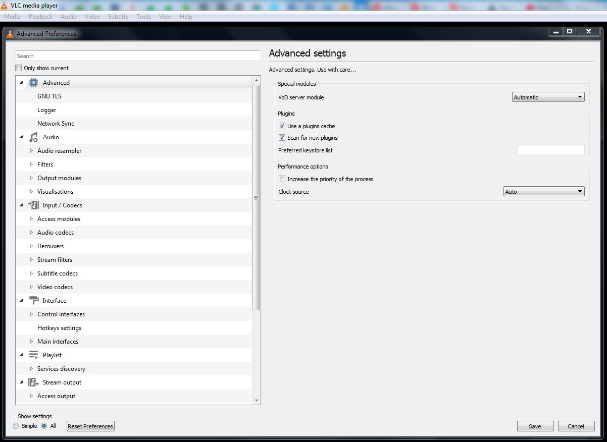

    How to display a simple view with limited option set and an advanced view with all options
    A lot of ideas already exists in other software. The first thing that came to mind is VLC. Switch of the mode at bottom left.
    I am open for suggestions and concepts that satisfy the needs of users with less encoding knowledge and pro users that want to optimize each single option.
    You should simplify current UI.
    First of all make a choice on using sidebar with icons or tabs in main window. Using both is a mistake. Choose the one and solid concept. I prefer sidebar with icons. It still allow to use tabs for chosen section in sidebar.
    Examples:
    Wrong: Icon General, tabs General and About.
    Correct: Icon General and icon About.
    Wrong: Icon Settings, tabs Settings and Logfile.
    Correct: Icon Settings and icon Logfile.
    Secondly, split General -> General to 3 icons - video, audio, muxer/format (or misc or other or etc.).
    Third, on Video icon make 2 or more tabs. But at least two: Encoding options and Side data (3D).
    Fourth, choose a concept for basic and advanced user. Variants:
    - wizard;
    - simple/advanced UI;
    - provide profiles based on original video bitrate, like output with high/medium/low bitrate;
    - leave it as is, but provide hints and descriptions which will help user to study and choose the right options.
