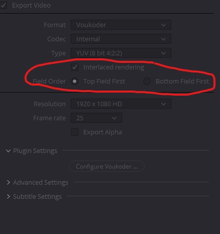

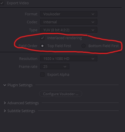

Hey it seems like i have found a solution but not inside the voukoder settings. I thought those settings are obsolete and ignored when using voukoder but the interlace option is actually working. Sorry to bother you with that.
Posts by HEEROCKSS
Hey Vouk. I wanted to ask if it is possible to export interlaced videos? In "Hybrid" encoder, there is an option to activate the interlaced option, cant find them on the voukoder prores version. Cheers
