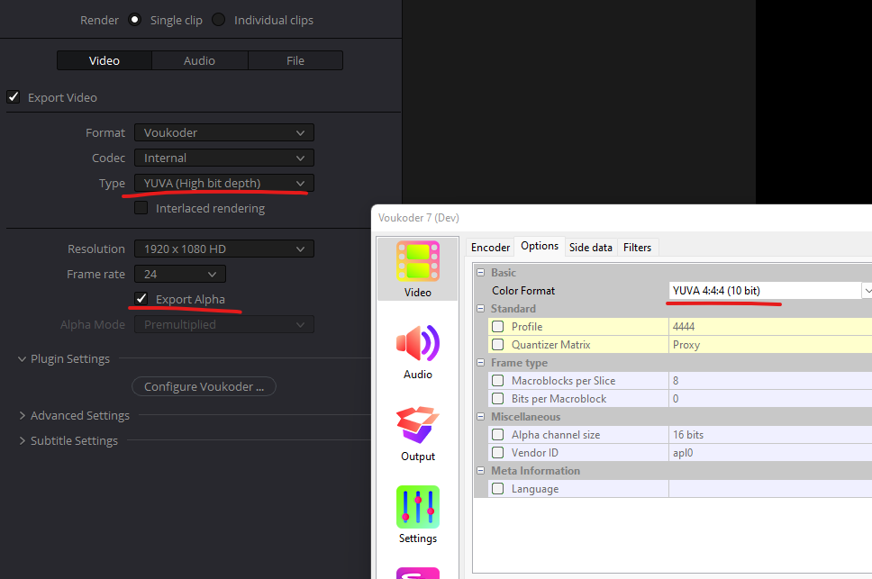

The Magix guys told me the alpha channel issue has been fixed already some months ago.
I'll investigate this again when I have some hours free time.
