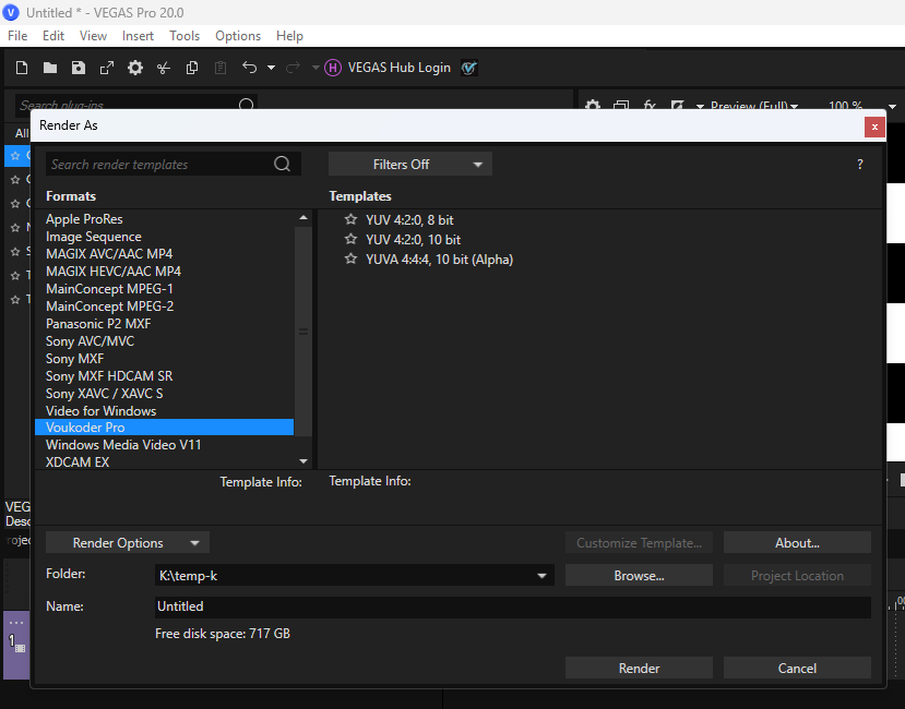

    In addition to Vegas Pro v22, I also have v20 installed on my PC. I uninstalled Voukuder and reinstalled it for Vegas Pro v20, and it worked:

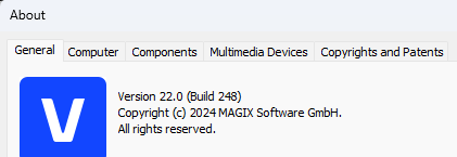

    I was able to successfully render a *.mov file. So, it looks like this issue is specific to Vegas Pro v22. FYI, I am running the most current release of Vegas:

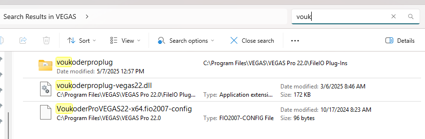

    Yes. The plugin is in the list:

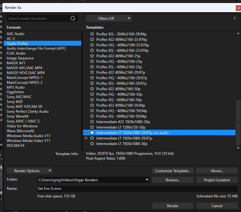

    I am a new user of Voukoder and I'm not able to get it to show up as a render option in Vegas Pro v22.
    OS is Windows 11 pro.
    I installed FFMPEG v7.1.1 and Voukoder Pro v2.0.10
    I followed the directions at https://www.voukoder.org/documentation/#3
    I got my 14-day trial license, ran Voukoder Pro and installed the license. Saved a scene. Ran Vegas Pro, but there is no Voukoder in the list of options:

    Looking at "C:\Program Files\VEGAS\VEGAS Pro 22.0" I see the file "VoukoderProVEGAS22-x64.fio2007-config" so I assume that means that the "connector" was installed properly.
