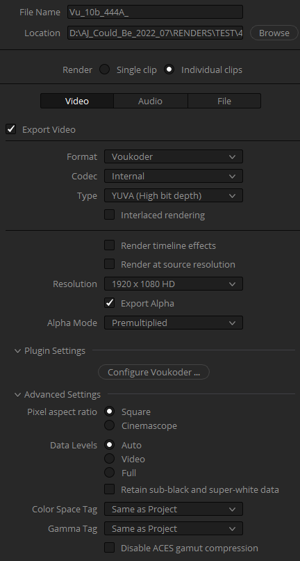

    Ah... the pulldown arrow/carrot does not appear unless you click on the color format. At first look, It appears that only the check boxes are there and usable only to add the metadata. Now that I know it is a chooseable option, it makes sense.
    Thank you.
    Upon testing, the alpha channel to a .mov now writes and reads.

    Any files rendered with Codec ProRes (either AW or KS) will not render or create the alpha channel.
    Channel is visible and verified.
    All files rendered are ProRes 422 HQ. All adjustments do not effect file codec or alpha.
    See attached snapshot.
